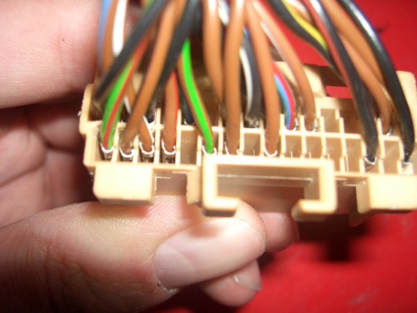

does the 1.4 loom look like this:
with the red/green wire in the first pin?

yeah

you need to move that into the 6th pin from the right.
thats all you need to do on the ecu end. if you post up some pics of the inside of the multiplugs (large blue plugs on the engine side) ill tell you what you need to do with them.
post pics of both the 1.4 and 1.6 loom.

whats stopping the 1.4 loom going into the 1.6 ecu? is it the 'fins' on the plug? if so, shave them off with a knife.

yeh just 1 fin

yes, you can use the 1.4 loom as long as you have the engine side as well.
you will have to use the knock sensor plug off the x16xel loom tho as the one for the 1.4 will be different. cut it off and re-solder it onto the 1.4 loom.

yeah i got it now keep both sides of the 16 knock wirin an connect to 14 loom

what is the green an red wire
its the knock sensor wire. on the x16xel ecu it needs to go to the other pin.
