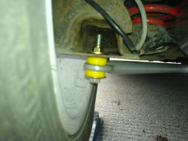

willay, did you use the cup washers under the bolt and nut? cant see them in the pic!
on which part honey bun?
under the bolt head and under the nut ya big ghey bear

on mine you can see the big cup washers.....
but I didnt fit the polybush inside the beam

yep
24th Aug 06 at 12:47   View Garage View User's Profile U2U Member Reply With Quote
well put it like this, i didnt have any bits left once i had finished.

ALSO willay this side is done up too tight!! And as said it does seem that you are short of some washers compared to mine?
Your not meant to deform the rubber bushs, it does state that in the instructions!! It needs some flex for some reason.

Was there a reason why not dave? Interesting how we all have them fitted slightly differently!

IIRC the instructions I had with the kit were non existant or had like a picture of it fitted and thats it

because the bolt wasnt long enough to fit the top bush on as well.

My whiteline bar had a big fold out instructions sheet with it, it was very specific about putting the enclosed white goop in between bushs and all metal, and about not overtightening, if you get the chance mate id get under there and slack it off a tad.
