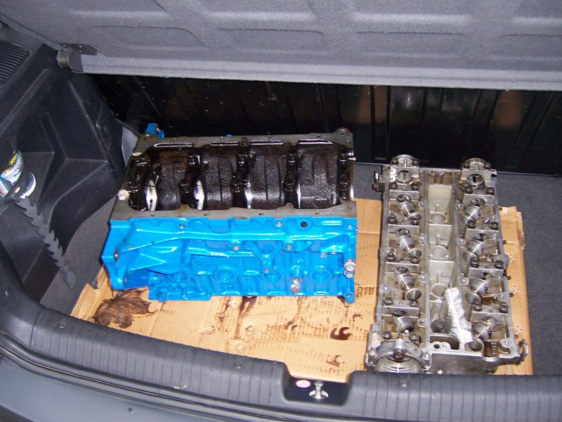

24.03.2007 - dropped my new block and coscast head of to the engineers this morning. the block is being acid dipped to clean it up and the head is havin some work done on it because i cant be bothered to do it myself on this one after the last one lol. hopefully the block will be done in a few days so that i can get it back and get it built up again and a fresh lick of paint. im thinking mayb white this time?

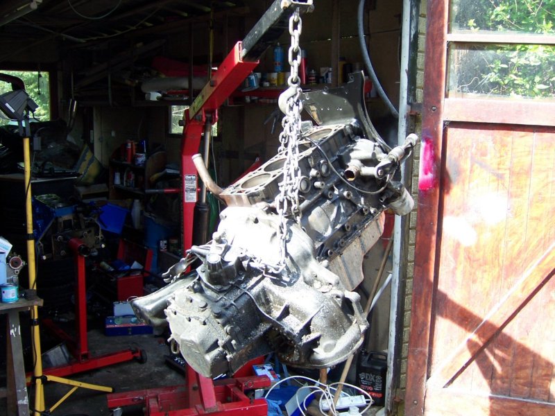

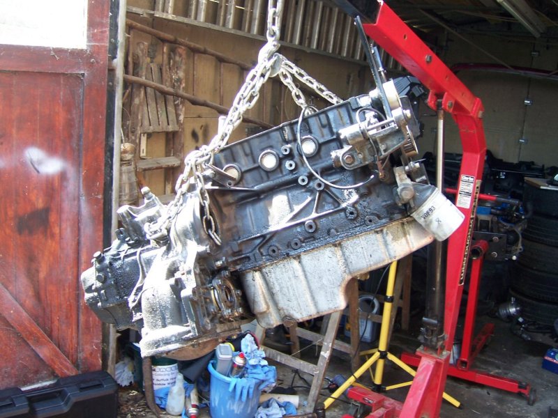

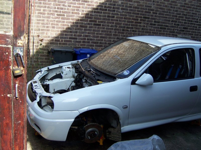

tonight i ripped my engine apart again as i got bored. why did it take a whole day last time and only a few hrs this eve?
heres some pics from tonight carnage!
12miles worth of shite -
and ready to be stripped again -

you must be a bit pissed off with the engine hope new lump is better one of my fav white corsas
28th Mar 07 at 07:39   View Garage View User's Profile U2U Member Reply With Quote
so why is it smoking? :S

not sure yet. there is slight slap on piston 4 so ideally it wants a set of piston rings, but that wouldnt cause it to smoke so much by changing the head. i think i might be dodgy valve stem seals (which are brand new) or its a cracked head. ive got to get a few prices on getting the head tested but im not really sure if i want to spend nemore money on engine as it will be removed and replaced before pvs. im tempted to remove whats left of it as it is and either brake the engine for parts or keep it for spares. dont think its worth my while rebuilding it to be honest as i would struggle to get the money back

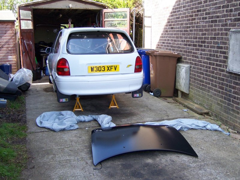

wanna get me a picture of the mudflaps at the back now you have your wheels off
jamesvalver
Registered: 21st Feb 03
28th Mar 07 at 18:41   View User's Profile U2U Member Reply With Quote
will get some when its light and i clean the mud off them.

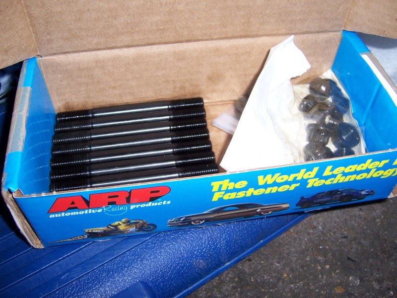

ARP main bearing stud conversion has arrived. thats another £90 on the engine rebuild
will be picking up my block from the engineers tomorrow morning as its been acid dipped for £15 + vat.

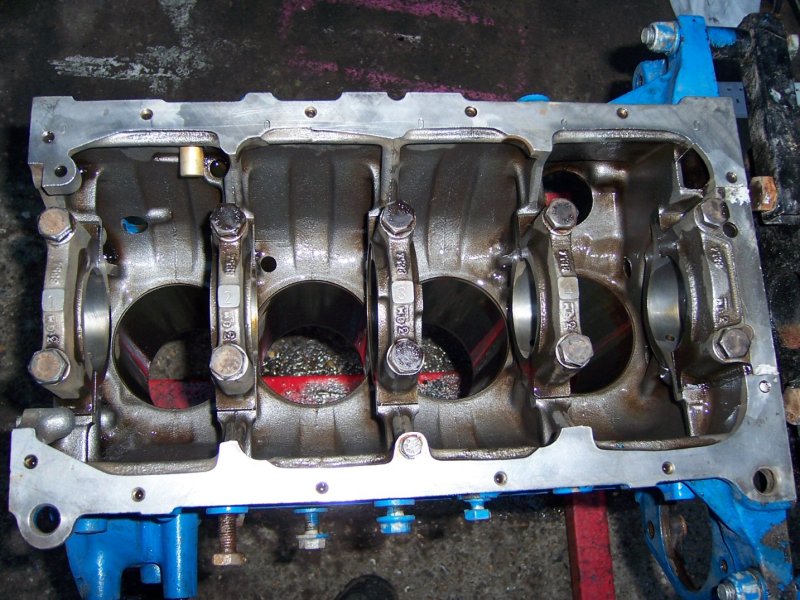

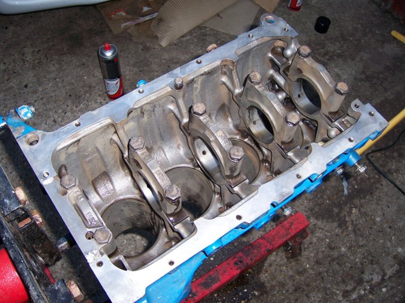

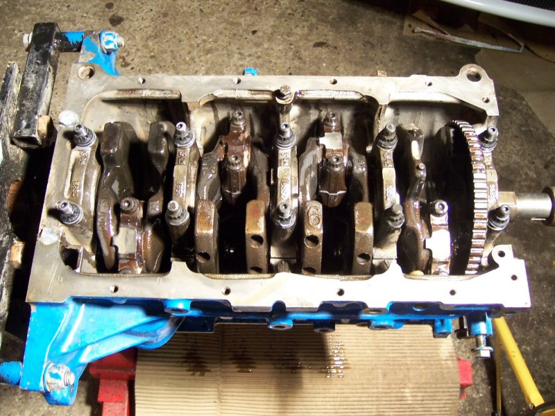

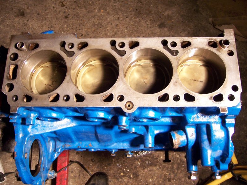

block is back now and i spent this evening rebuildin it. just need to re torque up the bolts then its ready be be put totally back together. next stage is to get whats left of the old engine out
jamesvalver
2nd Apr 07 at 23:13   View User's Profile U2U Member Reply With Quote

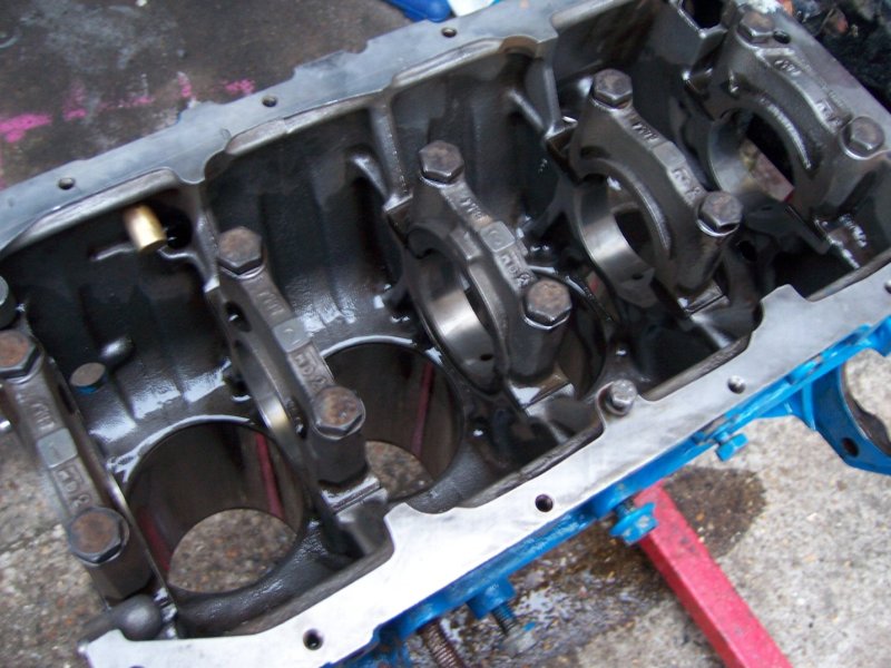

block is back from being chemically cleaned -

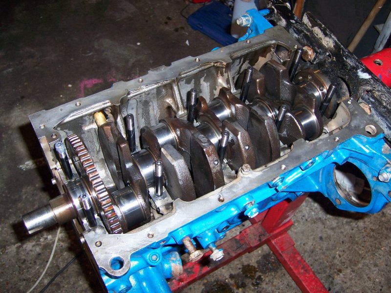

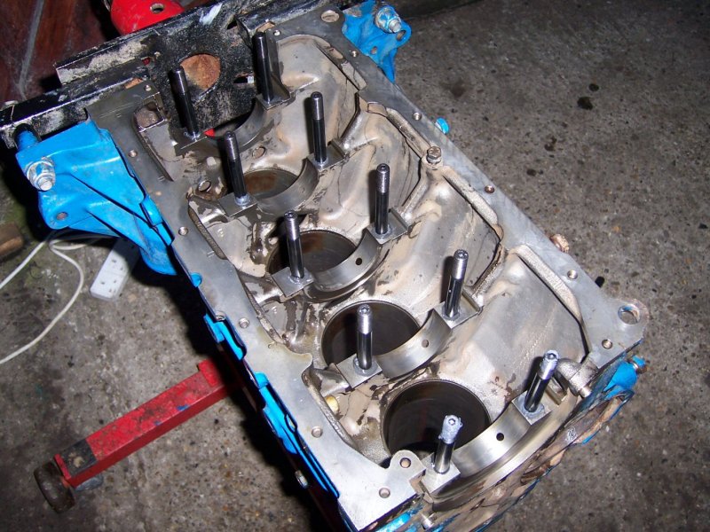

arp main bearing cap stud conversion kit -
fitted the stud kit -

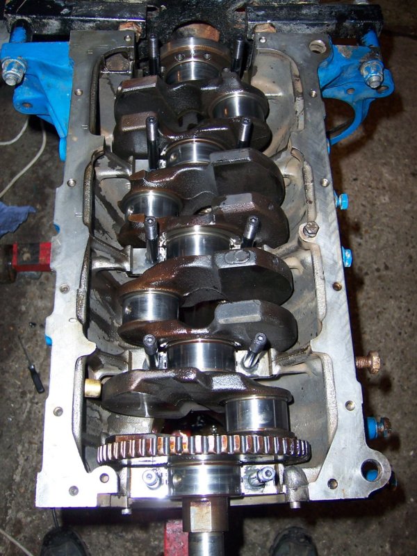

then fitted the crank -
pistons in -
thats tonights work. bottom end is fully arp bolted now. maybe flywheel bolts next? lol

some of those lobes look quite rounded ! on the camshafts
2nd Apr 07 at 23:54   View Garage View User's Profile U2U Member Reply With Quote
Where did the ARP bearing studs come frome James?
jamesvalver
3rd Apr 07 at 11:22   View User's Profile U2U Member Reply With Quote
waynep - they are very mild cams mate. slight increase over std but are suitable to run with std pistons
robin - i managed to track them down from courtenay. they were £90 delievered to my door

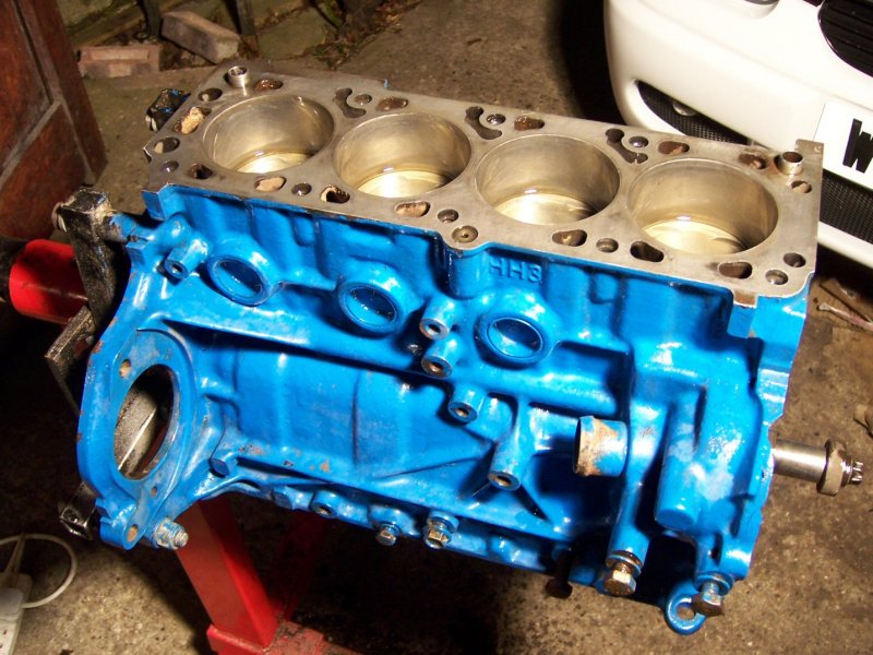

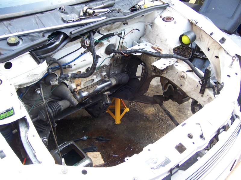

finally some more progress. ive been removing bits over the last week in the evenings along with getting my engine built propperly, and ive given it another coat of paint. will clean up my sump and get that fited today i hope
heres the progress from this morning. atleast you can see some progress this time!!
jamesvalver
6th Apr 07 at 16:35   View User's Profile U2U Member Reply With Quote
new engine is now ready for the head. im toyin with the idea of fitting the block and gearbox back into the bay once its cleaned and ive had the welding done then fit the head in the bay

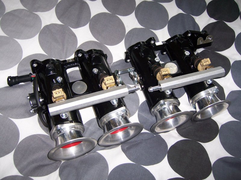

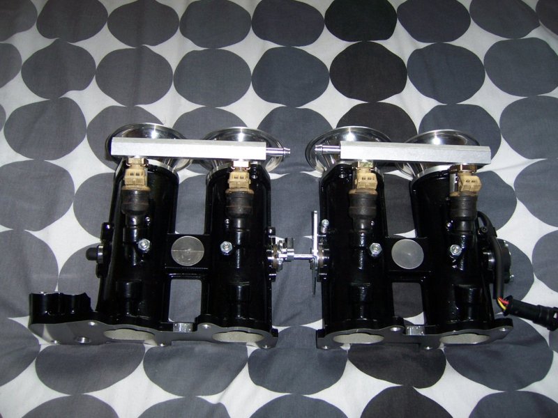

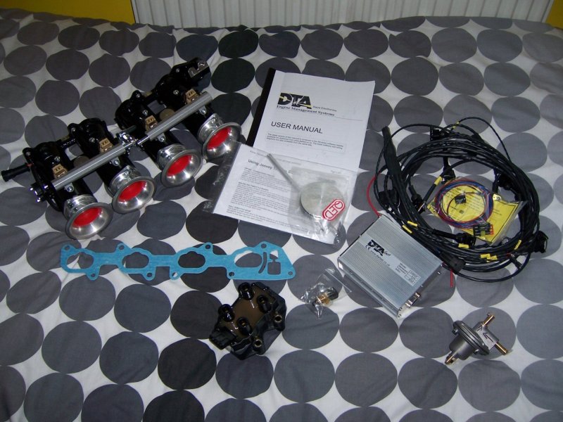

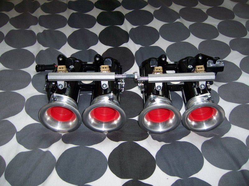

more progress, some new shiny bits arrived today
mps rear strut brace to match my cage -
jenvey DTH tb's inc everything to run them apart from a couple of hoses

lookin good james. i bagsy a ride in it once its all run in

oooh they look Cant wait to see it all done mate.
