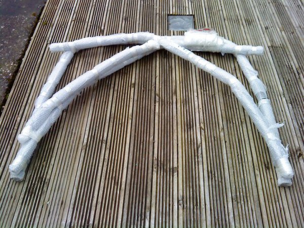

how much was the cage pal i got a de cat pipe here i will swop you for the cat pal

Cage
Yep, you're right about the exhaust - just a manifold gasket and downpipe to cat gasket needed. Although actually, are you going to separate the manifold from the downpipe to sort that snapped bolt?
Brakes and suspension can both be fitted before cage and paint too, if you need to do stuff before Ste gets back.
One last point - once you've dropped the coolant, I'd remove the rad as there's not much holding it in, then drop the oil, remove the filter and fit the exhaust manifold at least. From my experience, it's a hell of a lot easier to fit the exhaust with the oil filter off, and even simpler with the rad out of the way.
