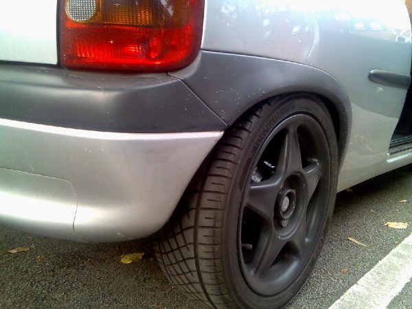

on car:
after 4-5 months on car and never cleaned:
