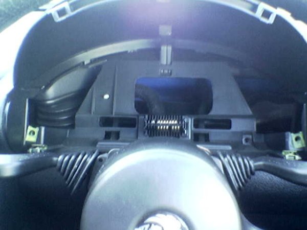

6th Feb 08 at 08:11   View Garage View User's Profile U2U Member Reply With Quote
yes!! piece of piece, follow the instructions in a Haynes manual you'll see there is no need to remove the steering wheel
need to remove the steering column surround plastic (3 screws)
then the "hood" (3 screws)
then there are a further three screws for the clock assesmble itself. its a fiddle to twist it passed the wheel but it does go.
it should be out in 12mins or better!

6th Feb 08 at 08:12   View Garage View User's Profile U2U Member Reply With Quote
to show i done it - you can see the three screw locations too (painted yellow)
