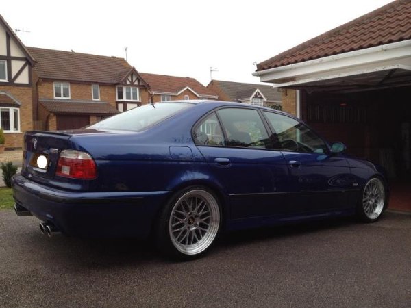

This is how i bought the car a few years ago, looked pretty reasonable, had non standard wheels on it, but i planned on sourcing std wheels and paintwork wasn't too good but mileage was good and history backed it up.

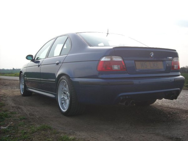

next i sourced some std wheels but in silver not shadow chrome and had rich of refined detail fame come and give it a proper clean up for me:

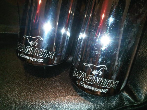

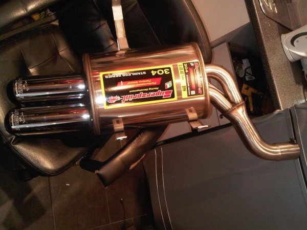

next up time to make it a bit louder, i fitted de-cats, x-pipe and magnum rear silencers from supersprint:

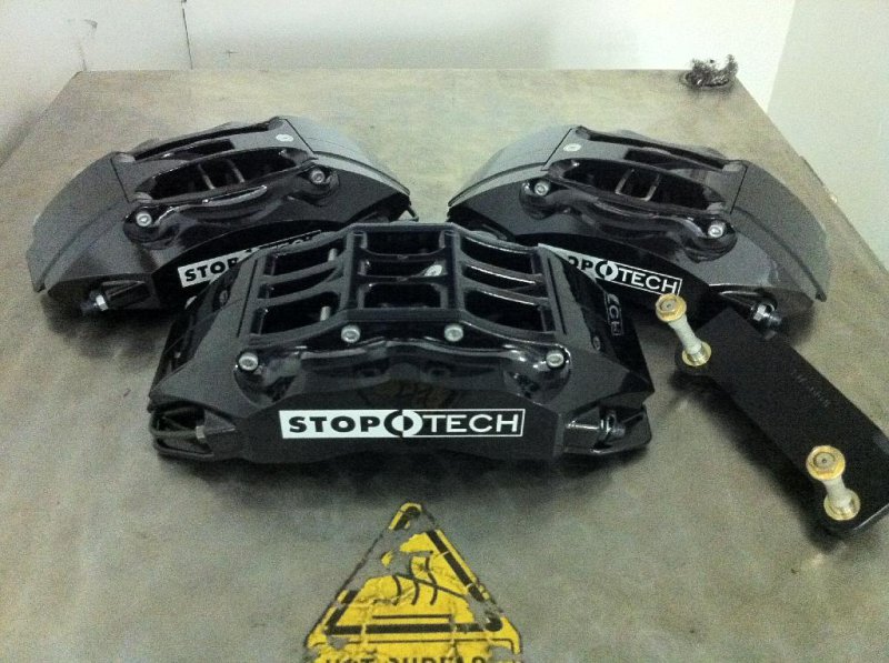

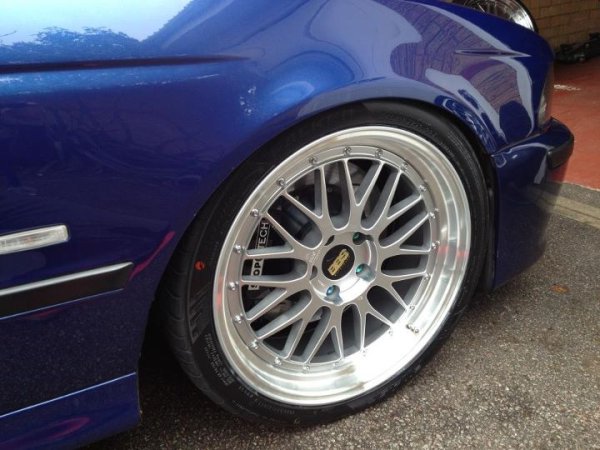

with plans to make it faster i got fed up of the standard brakes not lasting to long, already fitted a new set of genuine discs and pads to the front, so went the whole hog and got these:
Stoptech 6pots for the front and 4pots for the rear, with their bell and rotor kit, fronts went on straight away, no probs:
when fitting the rears i found the NSR hub carrier was bent, always had problems getting the wheel alignment spot on, despite replacing all the arms and bushes, so sourced a new hub carrier from a breakers yard (£70, BMW wanted £600+vat), then fitted the rear brakes:
had to use 10mm spacers on the rear to get them to fit the std wheels

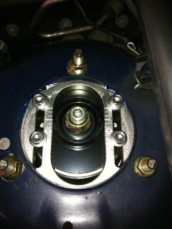

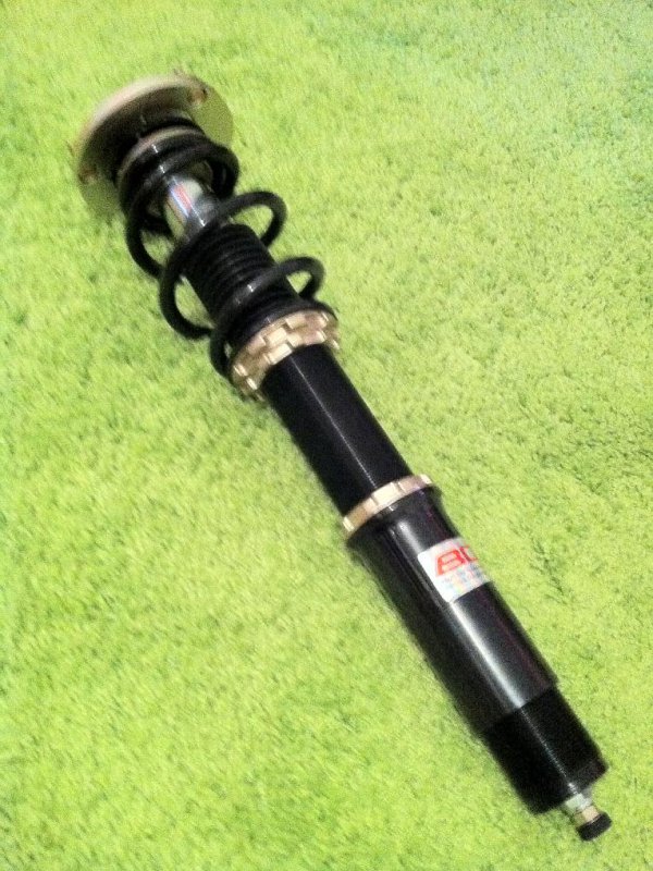

next up was to fit the BC racing RM series coil overs:
its a bit low at the moment but will sort that out when i get some new wheels:

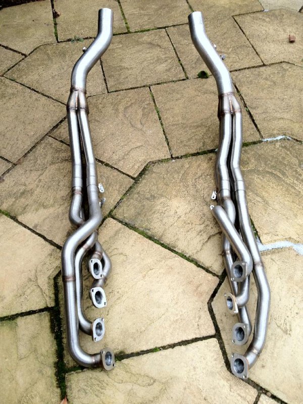

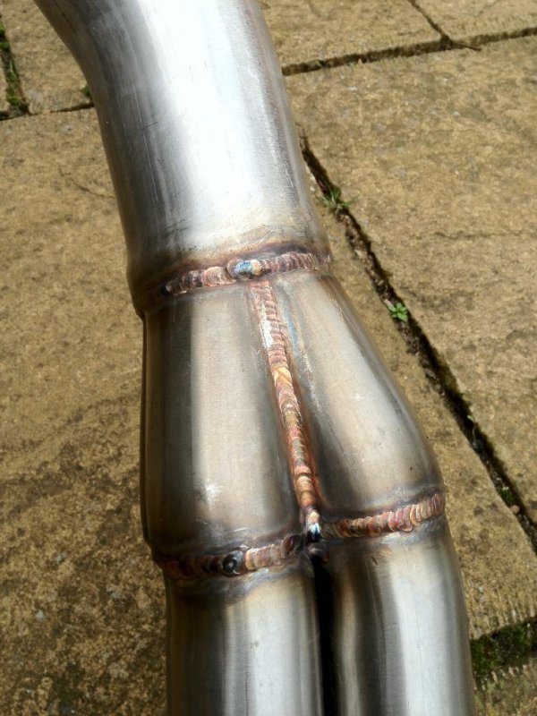

next to fit is these new manifold collected today:
once their are on, a little map should see the power up from 420bhp where it is now to 435bhp.

Them manifold are bloody awesome!

indeed, std m5 ones are the same as the 540, very restrictive

manifolds now on, new lambdas etc, got a problem with the fuel pump now tho since i ran it out of fuel, so ill change that, new filer then get it mapped.

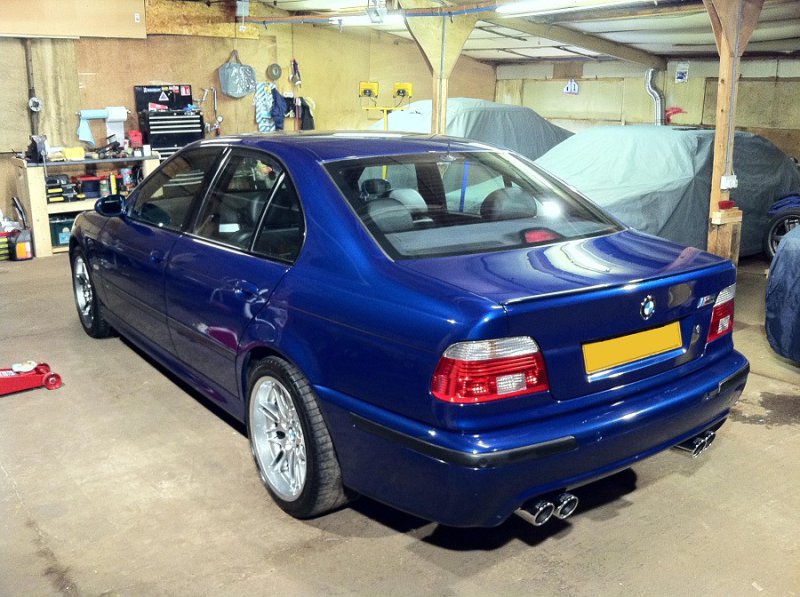

got my new wheels fitted in the mean time:
rear brakes now fit without the need for spacers, so no more rubbing either!
