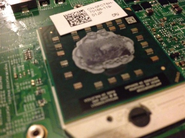

When I looked at the CPU it looks like loads of glue with gaps around it all bubbled kinda thing. I took a pic I'll try upload in a mo. probably the problem?

Does that look normal?
[Edited on 25-08-2012 by Dan]
25th Aug 12 at 11:42   View Garage View User's Profile U2U Member Reply With Quote
I can guarantee you Dell won't touch it, unless you pay
25th Aug 12 at 11:43   View Garage View User's Profile U2U Member Reply With Quote
Yes that's normal

Why did you remove the heatsink?
Dan
Registered: 22nd Apr 02
25th Aug 12 at 13:32   View Garage View User's Profile U2U Member Reply With Quote
Just to be snouty and have a look :/
For the sake of three screws I thought I'd have a gander.
I would have left it alone, last thing you want is anymore reason for Dell or the retailer not to fix it.

What difference would it make? I googled about it and everyone says leave it alone due to thermal paste?
I didn't see any on it?

thermal paste is the grey stuff in the pic. Ideally now you have removed the heatsink the old stuff should be removed and some new applied before replacing heatsink.

The paste was only on the underside of the chip though? I dunno hopefully I ain't made things worse for myself lol
No the grey grunk is the thermal paste, below that is the CPU sitting in a socket on the motherboard. What you took off would have been the heatsink.

You lost me lol. I assume the chip is shiny piece in middle? That has paste under it? Then the heatsink sat on top with nothing between them :/
The picture you posted shows a CPU (the whole dark green bit) sitting in a socket (white/cream bit on the motherboard) with thermal paste (grey gunk) in the centre of the CPU.
And what you took off is the heatsink.

Yea. I was more interested in the bit about thermal paste between heat sink and the CPU? Cause there wasn't I don't think :/

There is, it's in the picture.
