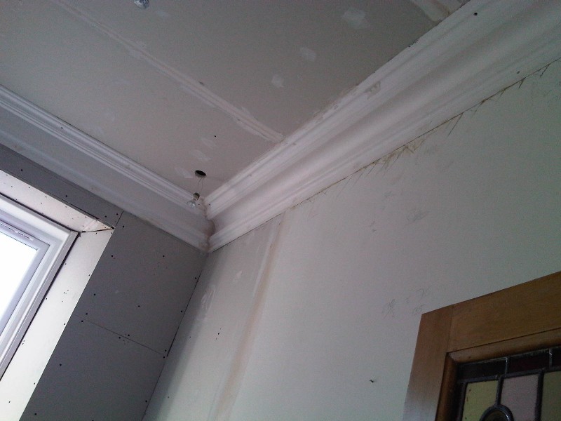

eventually got round to starting the bathroom (again )
Tiles off, bath and shower out, plaster off. Boarded walls and roof. Coving 3/4s up - need a had for the final section
Rob_Quads
Registered: 29th Mar 01
Location: southampton
20th Oct 10 at 16:48   View User's Profile U2U Member Reply With Quote
Would you not want to get all the plastering done before putting the cornice up?
AK
Registered: 5th Jul 00
Location: Aberdeen City
20th Oct 10 at 17:02   View User's Profile U2U Member Reply With Quote
eh?
Why do you need to plaster perfectly flat plasterboard?
I really dont understand why folk do that.
Tape the joints, and fill.
John
Registered: 30th Jun 03
20th Oct 10 at 17:27   View User's Profile U2U Member Reply With Quote
You need to be really really good at the taping though.
AK
20th Oct 10 at 18:16   View User's Profile U2U Member Reply With Quote
really?!
Doesnt seem very hard to me.
John
20th Oct 10 at 18:17   View User's Profile U2U Member Reply With Quote
It's not hard to tape, it's hard to get it perfect.
Rob_Quads
20th Oct 10 at 18:28   View User's Profile U2U Member Reply With Quote
This was exactly why I said. Its easy to smooth it off, think its all good, cover all the screws with a small amount of filler and think job done. Paint it, give it a few months to settle down and then often you start to see slightly different levels, slight divots where the boards have moved etc.
Plastering it off just gives you that nice perfect consistent layer that will stay level as its able to resist minor changes in the backing without affecting the surface
Daniel_Corsa
Registered: 21st Apr 04
Location: Wigton, Cumbria
21st Oct 10 at 07:30   View Garage View User's Profile U2U Member Reply With Quote
Be getting tiled over anyways won't it?! If was being painted I'd 100% be skimming over the boards!
