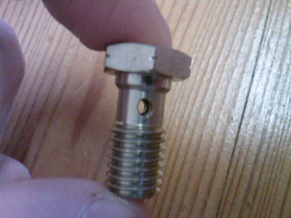

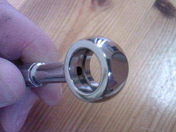

Looking at my braided hoses, how do i ensure that the little hole in the bolt lines up with the hole coming down in the hose?
(sorry its a bit hard to explain)
Marcy Marc
White Sport Progress Thread
Ste L
Registered: 3rd Jul 06
17th Mar 08 at 15:00   View User's Profile U2U Member Reply With Quote
you mean on the bit that goes in the caliper?
it wont matter, as the nut will have a cut around in it, so the fluid flow's around it to the hole it need to go into
[Edited on 17-03-2008 by Ste L]
Haimsey
Registered: 8th May 05
17th Mar 08 at 15:17   View Garage View User's Profile U2U Member Reply With Quote
Ah right. Yeah thats teh bit i mean Ste.
I hadnt noticed the cut out running around the inside of it
Thanks.
